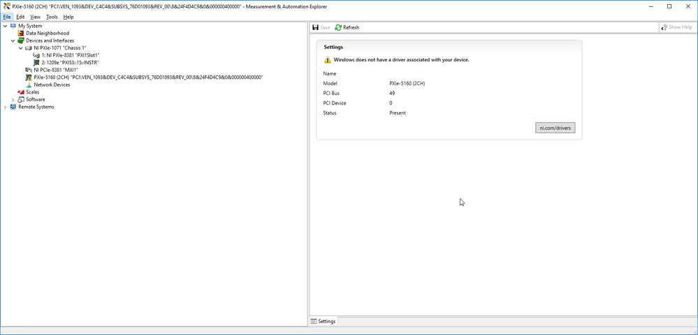

I just got my new NI modules, workstation and Chassis. I have installed LabVIEW 32, chassis drivers, and drivers that came in USB stick (NI System Driver Set 2017.10 ) and plugged in the PCIe-PXIe cable from the chassis to the host PC.
  1. NI device monitor does not recognize/detect anything
  2. NI MAX lists the following devices that are found by host PC but drivers are not available for PXIe 5160
    1. 2018-04-12 13_36_30-PXIe-5160 (2CH) _PCI_VEN_1093&DEV_C4C4&SUBSYS_76D01093&REV_00_8&24F4D4C9&0&00000.png
  3. Does NI Update Service automatically notify me whenever there is a driver update for my modules ? as well as along with other critical updates with respect to NI software?

1/2 - I am not sure what drivers are included in that. For the 5160 you need to have NI Scope installed. It is possible the system driver set did not have that included.

As for your advise that NI Scope was not installed, you were right. The System Drivers (USB Stick) I got when I ordered NI modules dint install properly. Had to do an complete uninstall and install the latest drivers I downloaded off from here: http://www.ni.com/download/ni-device-drivers-january-2018/7178/en/
That solved the problem.
