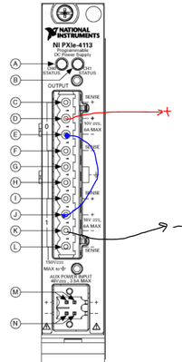

First, you can find the way I connected my devices to the power supply :
I chose to connect the 2 channels in serial to provide more than 10V.

Your connection seems good for Force lines but you did not provide information on how you connected the sense lines. And also you don't seem to have configured the sense mode in your code.

I didn't connect sense lines because I don't need to use them.
But I just read that the sense leads must always be connected. So I plugged my jumpers for a local sense HW configuration.
And I haven't configure the sense mode in my code.
But I just found out that the default value for sense mode is local. Therefore I think my problem is solved 🙂
