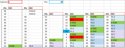

NI PXI-6341 16 AI 2 AO 24 DIO with TB-2706 Terminal Block Pinout spreadsheet
For the PXIe-6341 Multifunction I/O Module with 16 AI 16-Bit 500 kS/s, 2 AO, 24 DIO and 4 counters
https://www.ni.com/documentation/en/pxi-multifunction-io-module/latest/specs-pxie-6341/specs/
and the corresponding NI TB-2706  Terminal Block
https://www.ni.com/pdf/manuals/371459b.pdf
there is only a immage for the Pinout on NI websites ...
(2,371 Views)
Accepted by topic author code-lux
So I did an Excel spreadsheet with a sortable pinout list and a layout of terminals like in the TB-2706 where the type of terminals that shall be shown can be selected by choosing the corresponding collumn.🤓
A csv file is attached for those who cannot use xlsx files.
I hope it´s useful 😊
