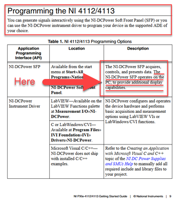

I assume the Soft Front Panel was intended to run on a PXI chassis running Windows OS and not NI Linux RT.  Is this correct?
I noticed in the IO Trace that the SFP software only looks for device on the localhost.
If this is the case, this seems like an oversight by NI.  Especially since the Getting Started Guide still states that the Soft Front Panel (SFP) can be used to control the device.
https://usermanual.wiki/Collections/National-Instruments/374897a.pdf
"The NI-DCPower SFP operates on the PC, to provide additional display capabilities."

Was there any claim by NI that the SFP will be able to control remote systems? i.e., instruments not on the same computer where the software runs?
Santhosh
Soliton Technologies
0 件の賞賛
メッセージ3/13
1,948件の閲覧回数
Actually yes, "operates on the PC" is pretty clear.
0 件の賞賛
メッセージ4/13
1,944件の閲覧回数
Unfortunately, it states that it works on a PC that contains the PXI module, by PC it is typically referring to a windows PC.
IMO, your case is not the same, you have a PXI module in a chassis that uses controller running NI Linux RT and that doesn't fit the definition of PC in general terms.
I beg to differ.  My use case is the same for all PXI instruments.  The implementation is different across various PXI instruments for some unknown reason.
NI didn't screw up the test panels for DAQmx devices.  The test panels actually DO access PXI devices on remote targets.
As you can see the DAQmx test panel software in MAX is smart enough to detect PXI devices on remote targets.
As you can see from the IO Trace, the first attempt results in an error "Device identifier is invalid".  The software then tries again this time using the IP address of the target.  Which is successful.
  1. Why couldn't this be done for the IVI PXI instruments?
  2. Why is the implementation different between PXI instruments from the same vendor?
A simple software-based test panel for a PXI instrument is not asking too much.  Especially since there used to be one that used to work.
