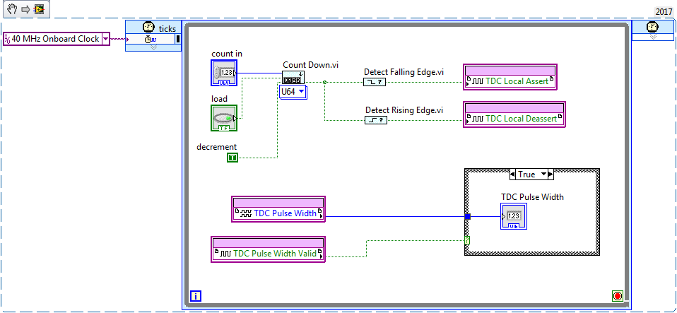

The TDC exposed on the 797x targets is a pulse expander. So toggle the assert then the deassert. The pulse expanding circuitry will then apply some expansion factor to the time duration between assert-deassert and return the duration of the expanded signal width.
Pulse Width = (TimeWhenDeasserted - TimeWhenAsserted) * ExpansionFactor
So if there are 10 ticks between assertions in the 40MHz clock domain and the expansion is 10 ( i don't know what the expansion factor is, I'm guessing) you'll get a pulse width of 100. Here is an example that you can use to test the TDC. Set the number of ticks you want to wait between assertions on 'count in', then toggle 'load'.
The tricky part is calibrating the expansion factor which may change some tiny amount if the ambient temperature changes. Let me know how it goes.

I was able to run the code. If my understanding about the FPGA code is correct, what it does is to start counting down from the count in value until 0, and Count Down U64 subvi output changes from False to TRUE, triggering the rising edge detector. After another tick, the value changes back to false and is detected by the falling edge detector. The delay between the two events will be expanded by TDC circuitry and output as TDC Pulse Width. So no matter what the count in value is, the output from the Count Down subvi is always a 25ns (1/40MHz) digital pulse. If that is the case, then there are a few questions:
1. Note that in David-A's and your example code, TDC Local Assert is connected to falling edge detection while TDC Local Deassert to rising edge detection. Shouldn't it be the other way around? Nevertheless, I ran your original code and the TDC Pulse Width was always ~2400 (with some single-digit variations). I then switched the placement of rising/falling edge detectors, recompiled the code and surprisingly the result was the same as your original code.
falling/rising edge detection switchedfalling/rising edge detection switched
2. To further test how TDC works, I rewrote the code by replacing the Count Down subvi with a Pulse Train Generator that output digital pulses of variable width (please see the attached screenshot below). If TDC works as I assumed, the TDC Pulse Width should change with the input pulse width. However it remained (almost) constant no matter of On/Off Time, and the result is about twice the value of the example code.
variable pulse width (FPGA)variable pulse width (FPGA)variable pulse width (host)variable pulse width (host)
It appears TDC does not work as expected. Or did I miss anything?

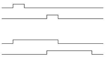

My apologies, the example I gave you incorrectly applies a single tick pulse to the TDC (as seen in the top half of the image below). What the TDC requires is an assert that remains high until a deassert is observed (seen in the lower half of the image below). The deassert should transition high before assert transitions low, it should also remain high at least two clock cycles. Doing this will help avoid avoid inducing jitter in the pulse width measurement.
Also you can use any clock domain you want for tdc assert and deassert. The pulse width and width valid must be in the 40 MHz domain though.
(4,776 Views)
