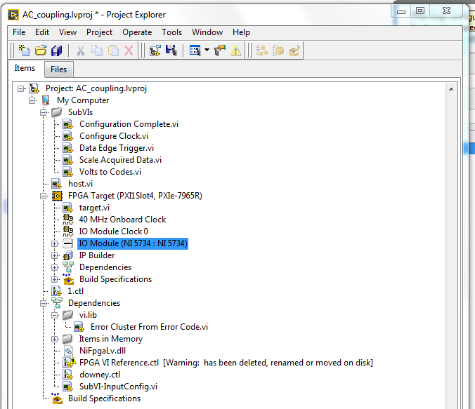

I am still having trouble changing the AC coupling mode to DC. As nobody else on the forums seems to be having this much trouble maybe I am doing something simple wrong. It seems others (https://forums.ni.com/t5/PXI/NI-5734-Hardware-Problem/td-p/1939391) have had success using the example code "NI5734 - Clock Select (FPGA)" to change the AC coupling, but I am unable to get this to work. This could be related to an error I get on compile, but for completeness, I will show what I am doing in hopes someone will see an error or be able to provide me with code that works on their setup.  My intention with this code was to be as simple as possible and as such, I am just returning values to the host VI to plot in a chart.
For starters, here is my project,

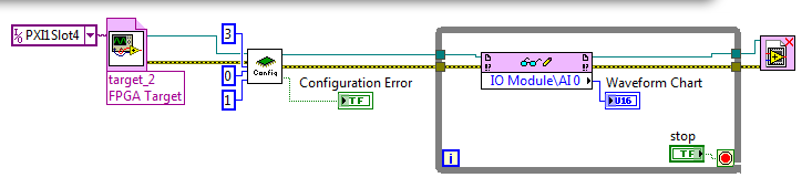

Next is the VI I run on the host. (This is a Windows 7 machine, I do not have any real-time interface). My only goal with this code is to set the AC coupling to DC and collect some data. The sub VI should take care of setting the AC coupling mode. The inputs are user command =3, user data 0 = 0 and user data 1 = 1, or in my understanding, set channel 0, coupling to DC.

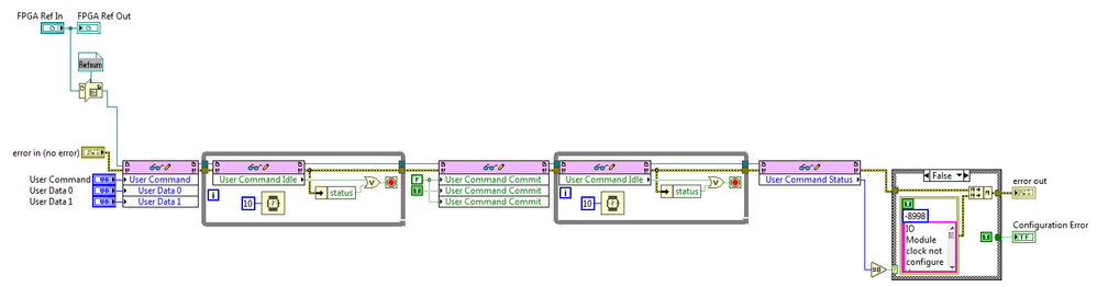

Here are the contents of the sub VI code. I gleaned this code from this link (https://forums.ni.com/t5/LabVIEW/Changing-GAIN-on-NI-5734-ADC-introduces-noise-ripples/td-p/2928098) but this is the same code as the set clock example, so my understanding is it should work. (Of course, it may not as I am still unable to change the AC coupling to DC.)

I was able to get it working. Here is code that should help others.
After much searching and deep within the FIDL library I was able to find some code that worked on my system. I think it had to do with how the commit booleans were set. For those interested, here is the code I used to set the DC coupling to AC (only for channel 1).  I have also attached the host and target codes to this post. picture.PNG
