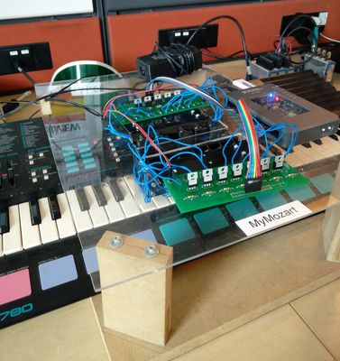

myMozart plays the keyboard using solenoid actuators which are positioned over each key in one full octave, giving 12 notes it can play. This can be re positioned to any other octave on the keyboard if needed. Additionally, using the 3OctaveOn variable the user can play notes from one octave on either side of the middle octave on the same keys, giving up to 3 octaves that can be played on the same 12 keys. This sounds good for some songs, and terrible for others so trial and error is needed to see if this is useful for any given song.
The solenoids are controlled with an on or off (boolean) signal which is provided by the FPGA on the myRIO. As the myRIO can only output 3.3V on its digital pins MOSFET transistors were needed to allow the solenoids to use a 12V power supply while still being controlled in this manner. (Information used from the Arduino tutorial here).
Hardware:
Mounting board- just needed to hold solenoids over keyboard, dimensions will be specific to the keyboard used. Mine is: … 320mmx440mm base, 130mm total height (20mm mdf base, 3mm acrylic top).Mounting Board for the robotMounting Board for the robotSteel Mounting Plate- To attach the solenoids to the acrylic section of the mounting board, I used 1mm steel (in my case a re-purposed drawer divider) which was measured to fit, drilled with holes to screw on the solenoids and bent at 90° Solenoids mounted on steel plateSolenoids mounted on steel plate

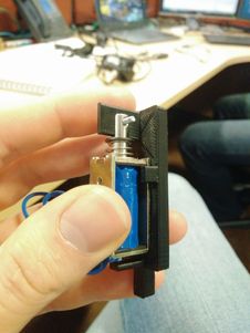

Solenoid Fingers- 3D printed solenoid fingers are used to translate the pulling motion of the solenoid into a pushing motion to press keys.  (See here for details on importing the attached .f3d files to Fusion 360)
3D printed solenoid finger3D printed solenoid finger

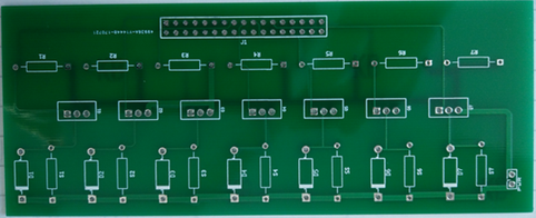

Electronics- Solenoid driver circuits were created to convert a 3.3V digital signal from the myRIO to a 12V power on/off for the solenoids. These circuits were originally built on breadboard then stripboard, and then converted to PCB using Multisim and Ultiboard, and the raw files can be found attached along with the Gerber files needed to print off the PCB's. (I used EasyEDA and their partner website LCSC to ship both PCB's and components together and they were fantastic).
Components used- 12*12V 10mm push/pull solenoids similar to this, note that when mine arrived they didn't have the section coming out of the top which would allow the push motion, which is why I needed to create the 3d printed "fingers".
12*MOSFET transistors such as these.
12*Recovery Diodes such as these
12*12kOhm resistors
