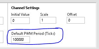

I'm working on HIL system, and we need to simulate some sensors using PWM Out channel, but we have to change the duty cycle and frequency of the PWM Out channel at runt ime, so is there any good solution for us to add both of the duty cycle and frequency items for PWM Out channel in Veristand FPGA XML Builder Node?  Same questions to PWM In channel.

Hey huazy,
Appologies for the delayed response. Using VeriStand's default PWM packet, you define the period as a static setting in the XML via the PWMPeriod tag. Within the FPGA XML node, you set this via the "Default PWM Period (Ticks)" setting.
The channel you then get in VeriStand is a duty cycle channel, which based on user input, varies the high and low times written to the FPGA and used to output the DIO line.
Now, if you want to control both frequency and duty cycle on the fly, this is totally doable and is an intended use-case. The RIO library functions that install with the VeriStand FPGA template include VIs and XML declarations to use the default PWM channel as well as control both frequency and duty cycle directly (See NI VeriStand RIO Library\IP Based IO\Pulse Generation\1 PulseGeneration.vi)
You do this by passing both high and low time yourself. So, to generate a PWM where you control frequency and duty cycle you would pass two U32 channels to the FPGA and they would represent high time and low time. You can use the scaling to convert from seconds, ms, etc into FPGA ticks. So, using the RIO Library and the FPGA XML node it would look something like this (for PWM generation):
As for scaling of the U32 channels, it depends on what you want your inputs to be. If you do it in time (seconds, etc) then you could scale that to FPGA ticks easily enough. Or you could have a model or something like that running the calculation and feed it down to the FPGA already in ticks. Developer's choice.
Hopefully that answers your question. Let me know if there's any other details you're curious on.
Thanks! --Ryan_S

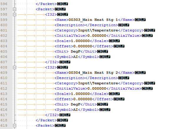

I have had success using this add on in the past, but am getting this error message when I try to import the FPGA into VeriStand.  Any ideas?  I have looked at the error line in the .fpgaconfig file and it looks fine.  I am using VS 2015 and LV 2015 sp1.  I can upload the project if need be.
Josh

Hey Joshe,
Nothing jumped out at me from the XML snippet and error. I'm wondering if it's a red herring propogating from an upstream error.
Can you upload the full XML file and FPGA VI? For the VI all we really need is the configured node, so you can delete any other IP if needed. That should let us take a closer look at what's going on.
--Ryan_S

Hi Ryan,
Sorry not to respond sooner, I was out of town.  Here is the XML and FPGA VI.  Thanks!!
Josh
