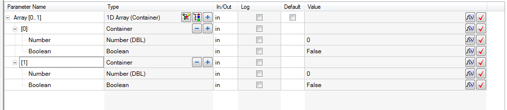

I have defined a parameter for a subsequence, as an array of containers(Number & boolean).parameter definition2.png
When I call this subsequence in Main sequence, in the parameter table I do not see the options to enter value for the elements.
There is only a field to enter the expression. I was expecting to enter values like this:value entry.png
Is it possible?

No it is not.  But you can go give your input on this idea:
http://forums.ni.com/t5/NI-TestStand-Idea-Exchange/Allow-Sequence-Adapter-to-expand-containers-in-th...
I WANT THIS!!!!!!!!
As a workaround we create the container as a local in the caller sequence and put the values in there.  The other option is to set parts of the container in a pre-expression if you are using other variables as the sub parts.
