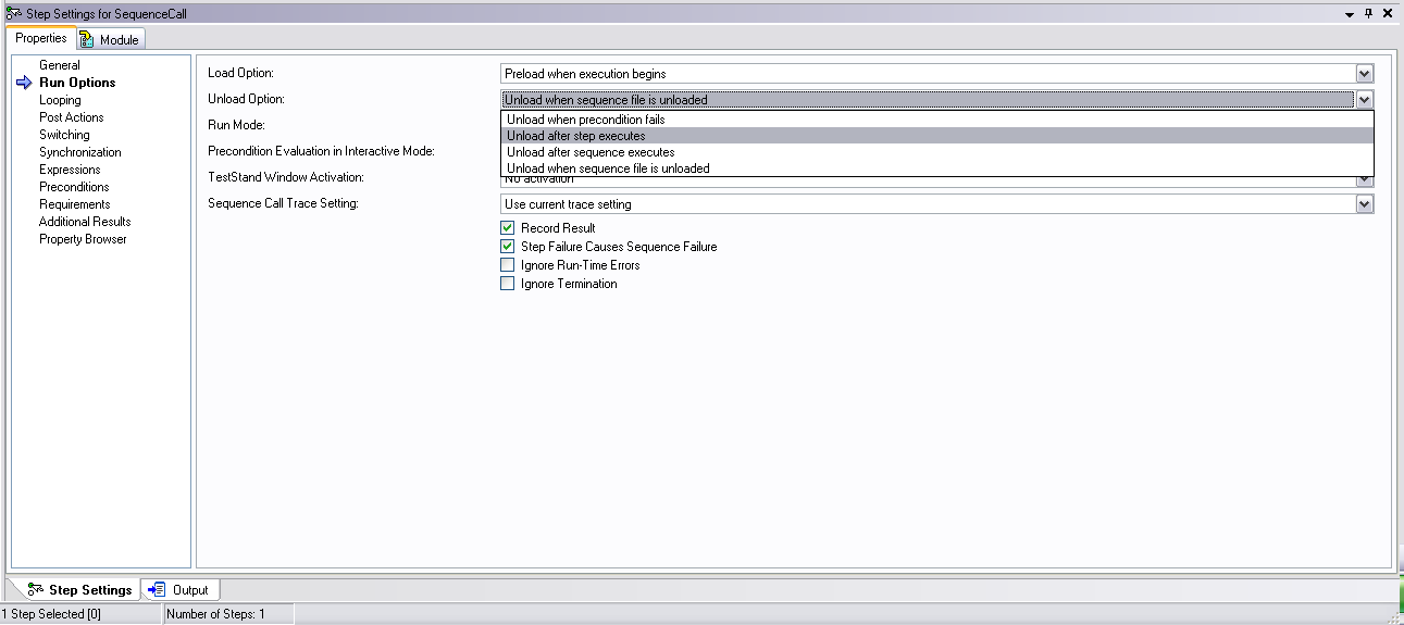

How can I unload sequence after it finished running?
In unload option I picked the unload after step executes, in MainSequence I did not set Optimize Non Reeantrant calls to This Sequence, but still the used memory did not decreased.

Thanks for the answer, but I need to run different sequences one after another (in one execution).
After one sequence finished running I want to unload it and to run the next one. The configurations I descibed in the first question should be enough, but still it did not work.

1. Select Step:
2. Here is what you need to do to dynamically load sequence.
3. Then  Unload after step executes:
Glenn Ellis

As I mentioned before, I did all of the properties you suggested (load dynamicaly too), but still not working.
Correct me if I am wrong, but if it was working, the memory that TestStand using suppose to decrease.
I do not use the UnloadAllModules(), only the properties of the sequence.

Here is an example.
I have sequence with all the properties you said. After the sequence ends I excpect the memory of TestStand to decrees (Task Maneger).
