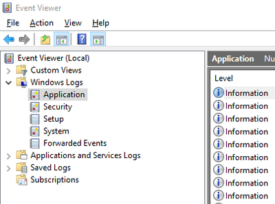

You could take a look at the Windows Events Viewer, specifically Windows Logs>>Application, to see if there are any Error entries related to the TestStand application you are launching. Maybe share the logged details with this thread.

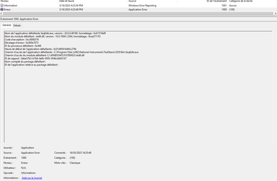

Hello Scott,
Thank you for your answer.
You are right, on the Windows Events Viewer there is a Error message after lauching the application. 
My laptop is in french. English version is the folowing
"Faulting application name SeqEdit.exe, version: 20.0.0.49180, timestamp: 0x61574e0f
Faulting module name: ntdll.dll, version: 10.0.19041.2364, timestamp: 0xea5711f3
Exception code: 0xc0000374
Error Offset: 0x000e7073
Faulting Process ID: 0x448
Faulting application start time: 0x01d9581b945c27fb
Faulting application path: C:\Program Files (x86)\National Instruments\TestStand 2020\Bin\SeqEdit.exe
Faulting module path: C:\WINDOWS\SYSTEM32\ntdll.dll
Report ID: 0ebe57b5-b7b8-4efb-9595-954bc6b65147
Faulting package full name:
Application ID relative to the failing package:"
Do you know what this error means ?  
Thank you
