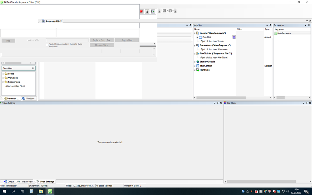

This is the most wierd error in Teststand.
The Top- Left corner of the attached picture is showing the Find Results and it won't bulge, inspite of starting Testand new.
It seems like some massive distortion here.
Has anyone solved such an issue ??

Got it 🙂
Solution : Alt+V  then Press R  (Reset UI Configuration)>> Accept by pressing Yes
