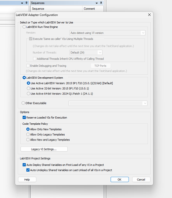

What do the LabVIEW Adapter Settings on your machine look like? Menu-> Configure-> Adapters-> LabVIEW

These are the adapter settings
Also Labview is working alone, and i can run VI's, open projects.

Ok, this is good news so far!
What I don't understand yet is, why calling a Python module using a Call Executable Step should screw up the LabVIEW Adapter.
Does it happen to use the TestStand API to configure stuff?
Just to make it clear: you are using the Call Executable due to the lack of Python support in your old TS & LV versions, right?

One last thing before repairing/ re-installing....
Change the LabVIEW adapter to Runtime, close and restart TestStand and after this switch back to Development Environment to re-chcek
Small hope but worth a try
