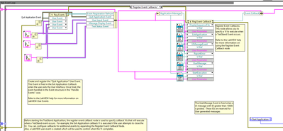

I have a test stand and labview system that is largely using standard templates to run. I had to convert all my VIs from 32 bit to 64 bit to solve another issue and now my Standard User Interface no longer launches my process model. I've attached the part of the code where i think the issue may lie and can provide any info requested. Before the conversion, this code would start the process model, prompting a user for part number, etc, before loading sequence files.

some further info, in case it helps. showing Register Event Callback and the configuration VI for everything.
