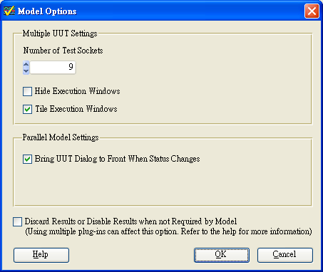

This issue confued me recently, I'd like to use a parallel model process, and to terminate all execution at once.
If there's some action steps in the sequence, it seemed all execution will be terminated.
However, I put a wait function instead of action steps, there are some executions not terminated while I pressed the Terminate All button in the toolbar.
Hope someone can give me some help. Thanks a lot.
ps. the number of testsockets is set to 9 in my teststand.

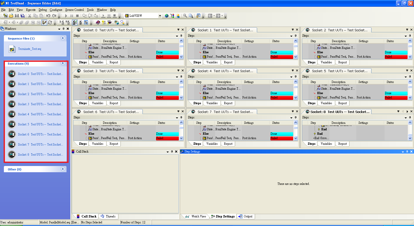

I'm sorry the attached sequence file is not good, it is eventually terminated.
The actual problem is like this attachment:
I'd like to use one of the testsocket to terminate all the other testsockets, the other testsockets are looping by the post-action before I terminate them.
When I start the termination, I'd like to do some actions in the cleanup.
There are 1~2 executions not terminated after the termination.
By the way, if I skip the wait function in the cleanup, termination all works.
I'm still really confused, could someone correct my understanding to the usage?

Once you change the Number of Test Number to 9,
You'll found your program will terminate automatically.

William,
I agree with Ting that the executions will not terminate if you have less than 9 test sockets. I believe you mentioned that you had set the number of test sockets to 9, but can you confirm that this is the case?

Thanks to Ting's and Daniel's reply,
It is too sad I still got some executions not terminated, like the attached image and video.
There are "usually" specified testsockets not terminated, but not always, it is clear between the attached image and video.
The version of the Sequence Editor I using is 4.5.0.310, I think it is not SP1.

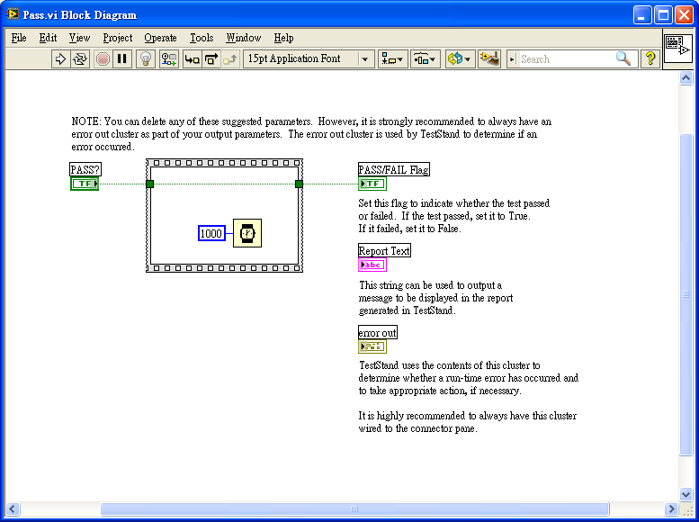

I ran your sequence again and I reproduced the issue.
It seems the post action of the Pass/Fail Test polls the VI with full speed.
It will consume your CPU resource to 100%.
So I add some delay into the VI to prevent full speed polling.
Please refer to the following block diagram.
I tried it and it seems the problem solved.
Ting
