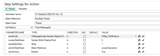

Just wanted to add to this, I would settle for away to programmatically set "New Vertical Tab Group" when I start my sequence in a new execution

Accepted by topic author kross8
SOLVED!!
Putting this here to help others.
There is a UIMessage that does what it says on the tin.
  • UIMsg_TileWindows–(Value: 23) Post this message to the user interface to instruct it to tile the windows the activeXDataParam parameter specifies. Use an array of ActiveX reference objects that reference a PropertyObjectFile or an Execution for the activeXDataParam parameter. The user interface tiles the windows that correspond to the objects in the array. To tile all windows, pass a NULL reference for the activeXDataParam parameter or use the Nothing keyword if you are using the ActiveX/COM Adapter.
Hope this helps
Kev
