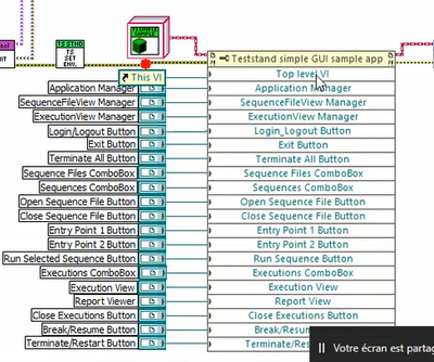

First of all.... having the screen capture helps a lot!
I would start investigating at this point
IMHO executing this node takes far too long.
I bet, there is some hidden run-time error / timeout in the routines above the code for the run "Entry Point 1/2 Button" registration and as such, the rest of the node doesn't get executed....

Thank you for your answer.
To have more visibility, I have change the property node by all Write properties VIs :
I can see my application takes time on the second VI when it initialized the application manager with the GetEngine function :
But nothing changed between the first and the second call, the function GetEngine is called on both and takes a little longer the second time.
I think the problems really comes from my Teststand initialization, so I don't know what to do...

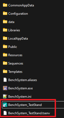

For now I've just do a temporary workaround by transferring the logic of the ProcessModel in my Sequence Callbacks, but I didn't solve my problem yet...
I have juste one more information : my problem happens when I load my Teststand environnement.
Indeed, for each projects, I used a custom Teststand environnement that I call by this way :
So, the first thing I do in my Teststand UI Module is to set the environnement like this :
When i disable this VI (therefore I guess the general Teststand environnent is called) the process model works the first time I run my application.

Thank you for your answer :
I modified the function like yours but I still have the same wrong behavior...
Message 9 of 13
(477 Views)
Are you setting the enviornment before actually starting the engine or after?
