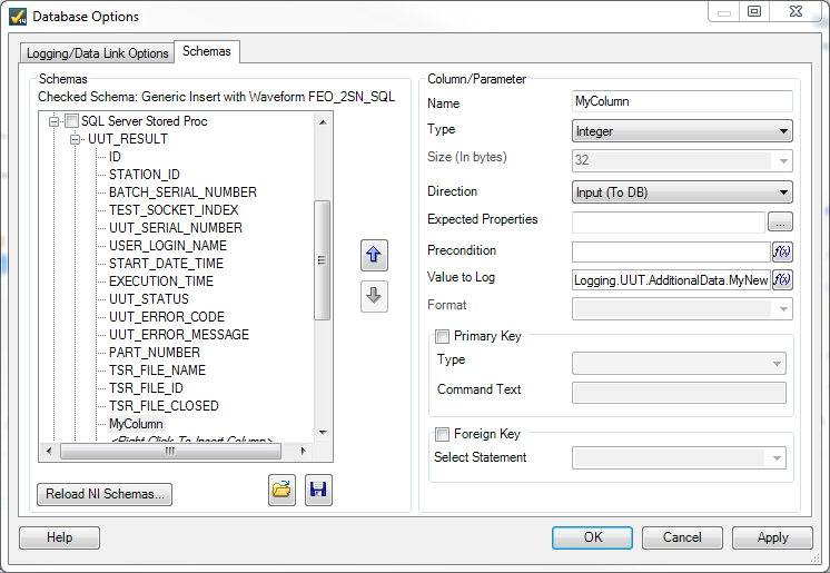

I'm posting this as additional documentation to what I've found on the subject. There's a lot of information online about database logging, but nothing I've found directly addresses this question. As someone relatively new to TestStand, I had a very difficult time finding relevant documentation and even more difficult time bringing it together to achieve the desired result. Figuring out how to log additional values to an arbitray location in a database should be as easy as the solution. Adding this functionality is most easily done through the TestStand API. There are screenshots and attached source files to demonstrate.
option: 1 = PropOption_InsertIfMissing

Hello Poolean,
Thank you for your post. It is very helpfull,  but I still cannot understand how to do same things for my NumericLimit steps.
Let's say I want to record to my custom table a NumericLimit step result together with some additional value (ExpectedValue, for instance)  which is different for every NumericLimit step in the sequence. How to configure Additional Results?
What  I should provide for <Value to log> from DataBase Options?
Thank you

Hi Poolean
thanks for your post, I managed to solve my problem following your demonstration! I would give you 100 Kudos for this if possible..
