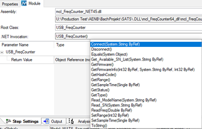

I've been trying to figure this out the entire day, but without luck. I hope you guys are able to help me out
I am using an instrument (Frequency. Counter) from Mini-Circuits. I need to get the measurements inside TestStand, onto my report.
Therefore I tried to implement the custom made .DLL for this instrument. Found here: "https://www.minicircuits.com/softwaredownload/fc.html"
".NET DLL from 27. October 2020.    .NET class library for automation via USB (Windows PCs)"
So I am asking - how do I call a .DLL within TestStand? I don't seem to be able to do this..
Thanks in advance!
BR Andedam

I actually managed to get to this point yesterday,  but I was still unable to extract data. What I have tried is:
At the .NET innovation, I need to first select the USB_FreqCounter()
After this I am prompted by a selection of commands ;
Here I would then first pick the Connect(System, String ByRef) command, and enter the SN as value?
Then I can make a new Numeric Value Test step for the same .DLL module, and select the function:  ReadFreq(Double ByRef)
As seen here:
NOTE: I am only able to select USB_FreqCounter and then another command. Then I am not able to select more commands in that step.
BR Andedam, really hope you can help me out

Hi Andedam,
First you should  connect to the equipment with Connect function, this should give some Reference, what you need to store in a variable (Local).
For the next functions you should include the reference when calling any other function.
After finishing close or disconnect.

Thanks a lot bud, I make it work. Thanks for the good advice!
