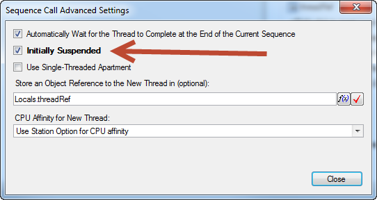

  I am trying to do same as you posted in  example in my code for launching new parallel thread but I am not getting 'Nothing' in the variable "parameter.thredref", as it is not valid thread reference add new thread not working for. I have mainseq inthat calling calibration as subsequence and inside that seq I have for loop to get sample there I need to launch new thread as parallel to the batch module threads, could you please guide me how I can get the new thread as parallel to batch threads
Message 5 of 10
(7,274 Views)
Hi Paddi,
The problem may be that you did not specify to store the thread object reference.  This option is accessible by selecting the Advanced settings button in the module tab of the sequence call step (asbutton.png), then specifying the locals.threadref  property in the advanced settings dialog:
Let me know if you are still encountering problems!

An alternative to using the notifier, is suspending the thread, and resuming in when the batch is created.
PS: I realize this is an almost ancient thread, but it came up when googling, because I had the same problem as Matthew_Kelton, so I thought I will share this input anyway.
The modified sequence uploaded is in version 2014.
