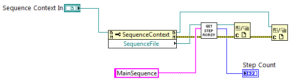

I have a better solution in the pictures below.  The code snippet is the code called by TestStand to initiate the recursion.
The attached code is the recursive call.  It's similar to my first post, but fixed a bug with typecasting references.
This should get the total step count.  The code works under a few assumptions:
1. All of the called sequences are in the same sequence file.  (You can add steps to also get the sequence file path and get the sequence from there.)
2. There are no Asynchronous LabVIEW steps in TestStand.  (These are treated as Sequence calls in the API and you would have to add code to sort them out.)

This is awesome, thanks so much!
Before I saw your 2nd answer with the code I created a new TestStand sequence and started converting your algorithm into TestStand API calls using 'Statement' steps with a Reursive sequence call back to itself.
I just ran a test 60 seconds ago and my error was because the sequence call was NOT into the same sequenceFile, its into a different sequence file.  I see you listed that one caveat so now I need to ferret out how to get that info; my guess is from the SequenceCallModule?
Also, I do not have any async calls so I'm good there.

The SequenceCallModule can also get you the sequence Path.  Your recursive VI will have to change to get the Sequence File Path instead of the sequence file reference.  Good Luck!

You can use the GetSequenceFileEx method (for the TestStand Engine) to get the sequence file reference from the path.  I haven't really tried this in a recursive VI (which will also need the Engine as an input), so I'm not certain everything would work perfectly.

Thank you for all your help.  Using your LabVIEW algorithm and suggestions I was able to roll everything into a TestStand sequence that supports calling into multiple sequence files.
I've attached a sequence file that contains the recursive sequence.  This sequence just needs to be put in the 'DoPreUUT' sequence of the process model with the following initial values:
sequenceFileRef = #NoValidation,RunState.ProcessModelClient.AsPropertyObjectFile.AsSequenceFile
sequenceName = "MainSequence"
runningTotal = Locals.runningTotal // Locals.runningTotal is initialized to 0
