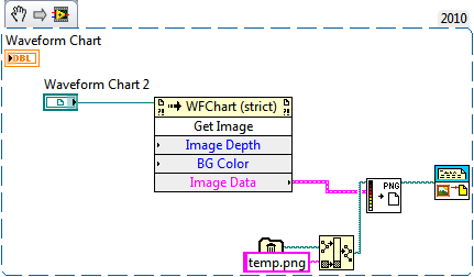

I am using Report Generator took kit to put the data I want and where I want into a specific excel file.  However, I would also like to import the image from a strip chart as well.  I figured out how to export it to the clip board but I don't know how to paste it into excel.  Any ideas?

If you save the image to a temporary file, you could then import it to the report:

It took me a bit to find everything in the palettes but once I did, it worked perfectly.
