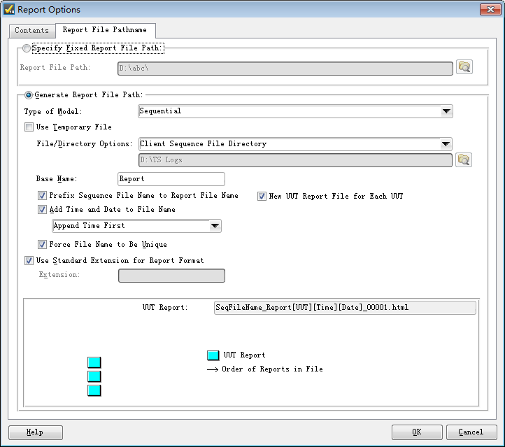

Hi Steven,
If I want to change the report path after uut done How should I do?  and i observed the report file generated after UUT Done executed
(962 Views)
You should be able to achieve this using the ReportOptions DIalog Box.
Are you actually refereing to the path ("folder") where the file should be stored or the file name?
