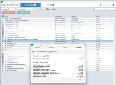

Encountered error when installing TestStand 2024
     Anyone encountered this error when installing TestStand 2024? Thanks

I encounter the same error when installing NIDAQmx driver https://www.ni.com/de/support/downloads/drivers/download.ni-daq-mx.html#484356
Anybody can help?

This is a bug in NI Package Manager 2025 Q3 and will be fixed in 2025 Q4 release. In the meantime, please cancel the installation if you get this error and restart the installation - this should continue from where you left off.

Repeating the installation again if the error occurs works fine until the last product.
I can not install the NI-DAQmx C support.
I tried to repeat several times but it always stops with the Parametername: key should not be null
(306 Views)
the C-Support I installed than with the offline installation (ni-daqmx_23.5.0_offline.iso)
Than repared it with the Package manager
I hope the left over error does not minde....

The root cause seem to be a slow internet connection, please retry the installation.

NIPM patch release with fix has been published. You can either click on the Update now option in the banner or download and run the NIPM online installer to get the patch.
