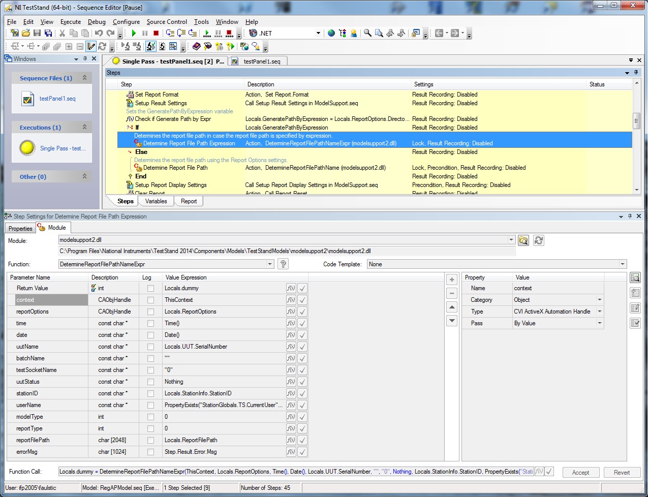

In my Process Model Sequence is a call to DetermineReportFilePathNameExpr contained in modelsupport2.dll . (Teststand 2014 64 bit)  This call makes the Teststand Sequence Editor stop working. I guess (?) that the reason are missing DLLs as follows

The following message occurs when the step is executed (single step, single pass). Unfortunately this is all, no further information is available .
Then the Teststand Sequence Editor works no more.
The step in my custom process model causing this message is as follows:
The values passed to the function DetermineReportFilePathNameExpr  can be seen.

Hey Rainman,
TestStand ships with the source code for modelsupport2.dll. It is located in the TestStand conponents directory:
32-bit: C:\Program Files (x86)\National Instruments\TestStand 2014\Components\Models\TestStandModels\modelsupport2
64-bit: C:\Program Files \National Instruments\TestStand 2014\Components\Models\TestStandModels\modelsupport2
You can compile it if you have CVI on the system. If not, you can at the very least still look at the .c files and see what is going on in the code.
For this particular funtion, it looks like we changed it over the years. The newer version of the function is DetermineReportFilePathNameExprEx2 and has two more parameters: processModelClientPath and uutPartNum. If you are creating a new process model from scratch, this is the call you should use so your process model is more exstensible should you ever decide you need that information.
Try the DetermineReportFilePathNameExprEx2, and pass values in for processModelClientPath and uutPartNum. If that still causes TestStand to hang, then I would recommend building a debug DLL to see the line of code where this happen.
Edit: Also try passing a value or empty string "" for uutStatus. Passing Nothing might be a problem. I don't expect it to be a problem because TestStand converts this to a Null point of the appropriate architecture, but it is worth testing out.

I filed Bug report 572171 for this behavior. The work around is pass empty string "" or any value in DetermineReportFilePathNameExprEx2 for the uutPartNum parameter.
