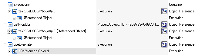

Mat -
Evaluate() returns the actual Property Object where as GetPropertyObject() returns a Property Object that contains the actual Property Object as a Referenced Property Object. See the image below:
The Locals.getPropObj variable was set using GetPropertyObject() whereas the Locals.useEvaluate variable was set using Evaluate(). As you can see, Locals.getPropObj is actually a Property Object that contains a reference to the Executions.zeYt36eLr060JYbbyoXyIB Object Reference. However, Locals.useEvaluate is a copy of the actual Executions.zeYt36eLr060JYbbyoXyIB Object Reference.
We are considering adding de-reference operators in a future version of TestStand. Hope this helps.
