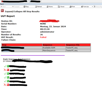

It creates the TempReport AFTER running my test run. But only when I confirm with ok and then no longer want a new run. It's the UUT Report tr5expand.
But I would like it to create the TempReport at the end of/during the test run like the PDF report.
I hope you know what i mean.
Thats the TempReport, which is also stored as a temporary .html and its better than the generated PDF because you can expand and collapse the results:
Cheers
Tobi

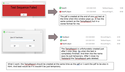

Yes I know these options. But if im not wrong its only possible to configure the .xml-report.
But the Report i want is the .html-TempReport which is generated right after the test. It is the report which can also be generated as a PDF but in the PDF there is the function of expand/collapse not possible.
Long story short: I try to generate the .html-Report (not after testing) at the time when the PDF is generated (at the end of the test). Is that possible?
That is generated at the end of the test:
And this is generated after the test:
 The content of the file (pdf - html) is the same but i want the the .html best at the end of the test (not after it), because of the functions (expand/collapse).
Message 6 of 9
(3,844 Views)

I only want to test 1 UUT so just 1 runtrough.
I hope the following picture makes it clear.
