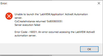

thanks for replying so fast. I am trying it. In order to use 'update VI calls', I must config the Adapter to LabVIEW development module.
But then this error comes.
If I ignore it. And try to update VI calls
This sequence will run automatically and this error appears
What is wrong?

Are you using Absolute Path?
If you are using Absolute Path use relative Path.
In the search Directory you can configure the directory path based on the location you used to keep your Files
