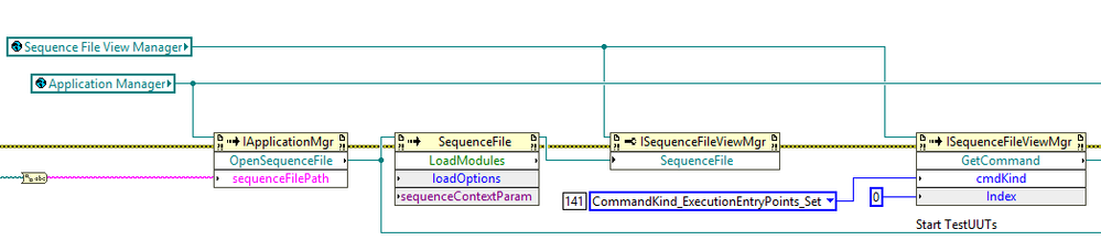

Here is the complete set of methods and properties that are working well for me:
Message 9 of 11
