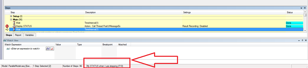

I have ActiveX call of a method PostUIMessageEX  and it only displays messages in Teststand status bar if I set up breakpoint in my sequence and then use F10 to execute method call.
For example, see this image:
Here I get string "My STATUS when I use stepping (f10)" in TS status bar, but if i just run TS seq file without breakpoints, i cannot get status...

It works for me with TestStand 2014. Make sure that the execution window is the active window. The progress text is only displayed for the active document. It switches when you switch documents.

I attempted to reproduce your problem but was able to see the UI message posted using the same code that you provided. Do you see the same thing if you use the following expression in a statement step:
RunState.Thread.PostUIMessageEx(UIMsg_ProgressText,0,"My STATUS when I use stepping F10",Nothing,True)

That was the solution. Status posted using PostUIMessageEX is only displayed when execution tab is selected. Thanks!
