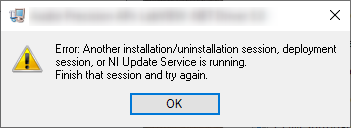

I am trying to use NI Package Builder (NIPB) to create a package to deploy some external software via a package. However one of the installers is a LabVIEW created Installer. When I try to call the setup.exe, it tells me that it cannot be run since another NI installation is running. I am assuming the other installer is NI Package Manager itself. Is it possible to call or include a NI Installer in package? Could the issue be I am trying to call setup.exe to automatically install (specfile /qb /AcceptLicenses yes)?
The NI Installer I am attempting to install via package

I got the exact error message from when the NI Installer is run.

Try passing a /noMutex flag to the LabVIEW setup.exe as one of its command-line parameters. This should work because both NIPM and the setup.exe installers normally block each other so that you can't run two installers at the same time. This command-line flag causes setup.exe to not raise its blocking mutex.
(5,747 Views)
Thanks WesW. That did the trick and now it will install.
