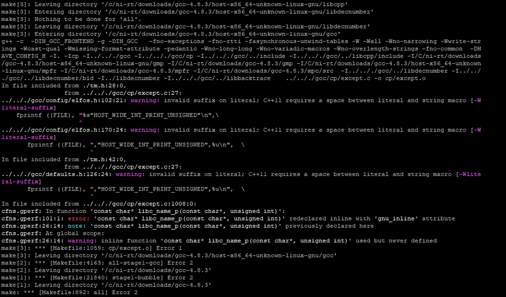

I am trying to do the process into a cRIO-9049 (NI Linux Real-Time x64 4.14.87-rt49-cg-7.1.0f0-x64-41), but I get the following error after executing the "make" command.Make Issue.png
Any idea?
Thank you!
