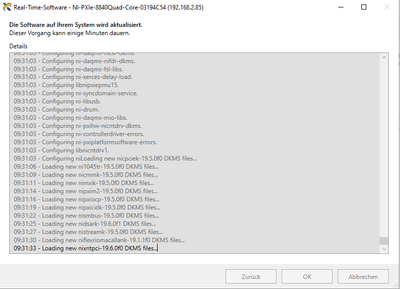

Hi, I did all the steps needed to install linux on my PXIe8840QC but when trying (Be it Q1, Q2 or Q3 images) it gets stuck on the "Loading New nixntpci.." (See atached image) And then it throws an error. The PXI just stops responding to the keyboard an I have to hold the power button until the power is cut down.
Any ideas?

In case someone has the same problem, I "fix it" by not installing the whole software in the PXI at the same time but doing "Installation rounds". I don't really know if it was coincidence but it worked for me. Rounds that I used:
Round 0:
-Image Q1 for PXI
Round 1:
-XNET
-LabVIEW Engine
-PXI-Services 19.1
Round 2:
-NI-DAQmx
-NI-RIO, R, Server
-FlexRIO
-LabVIEW control and sim
-Net Variable Engine
-NI-SLSC
-NI-VISA PXI
-Variable Client
-Needed Dependencies
Round 3:
-VeriStand
