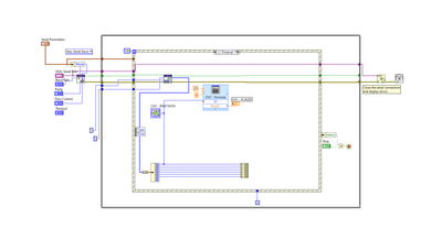

I wanted to give a quick update on some of the Modbus communication that I was doing previously.
With the help from ShivamSaxena, I transitioned into a case structure-based data collection loop. This helped me keep distinct states during the process of data collection separate and allowed me to debug knowing what part of the case I was erroring at. I also made some changes to the way that the program samples with the advice about the wait time as well. You can see the new structure below:
If you notice the modbus master on the left side, I changed my communication to serial. Previously, I had been wiring the weather station to an RS-485 to ethernet converter and trying to do TCP protocol for the data collection. This was giving me a headache with the error 56 and I cold not figure out if it was failing at the weather station, ethernet converter, or the LabVIEW script. I ended up adding in a local router between the converter and my laptop to see if that helped, tried another ethernet converter from a different manufacturer, and even tried different computers. Nothing resolved this so I bought a serial converter and have had no problems since this transition! I am far from an expert at Modbus communication but the amount of time I put into debugging the TCP master was an issue. Maybe this will help someone in the future so I decided to post some updates.
Thanks for the help from the forum!
