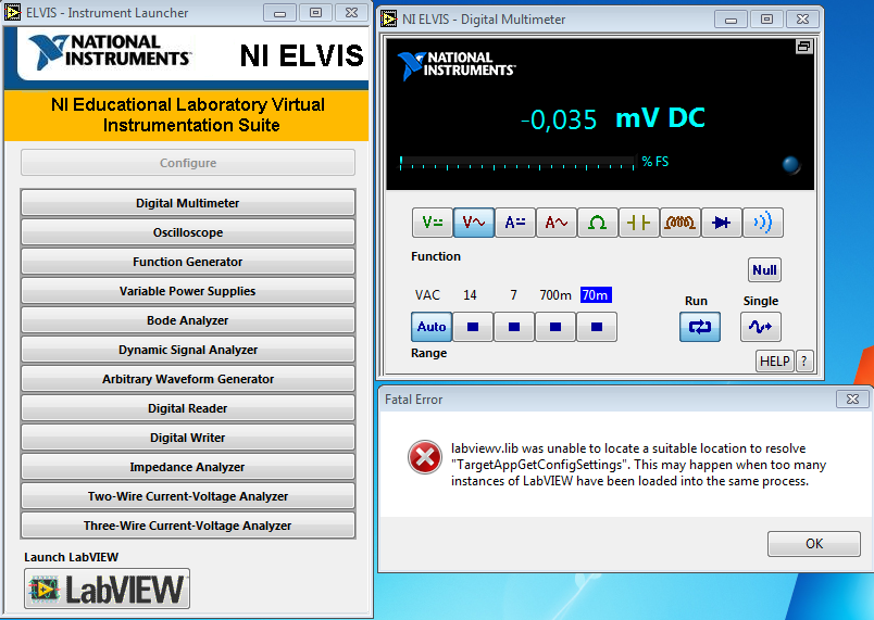

Hello!
I have a problem with old NI Elvis (first version). I install 3.0.7 version of drivers and ELVIS Traditional starts, but when I try to measure AC Voltage then I get Fatal Error, that says "labviewv.lib was unable to locate a suitable location to resolve "TargetAppGetConfigSetting". This may happen when too many instances of LabVIEW have been loaded into the same process".
Does anybody know what should I do?
I have LabView 15 SP1, Win7 32bit (same error with x64), DAQmx 17.1. Also changed labview.ini file with "AllowMultipleInstances=TRUE" parameter.
Thanks!

Hello!
I removed LabView 15 and all NI components (drivers for PXI modules that we have), installed old 8.6 LabView and old drivers for PXI (don't remember version) and Elvis drivers 3.0.7. Now Elvis works fine, but unfortunately old drivers for PXI modules have different API, so my python (nifgen, nidmm) scripts are not working for now with PXI-4064, -5402.
