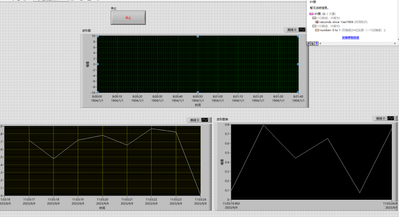

在遵循了https://knowledge.ni.com/KnowledgeArticleDetails?id=kA03q000000YGxCCAW&l=zh-CN的提示之后,只有波形图X轴时间显示不正确,问题的关键是我需要用并且希望只用波形图来显示数据,希望帮我看一下问题出在哪边,以下是前面板截图,附件是我创建的vi。

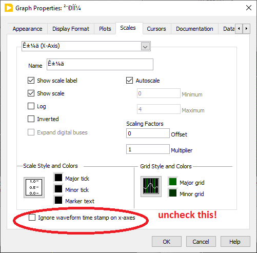

You are ignoring the waveform timestamp, so uncheck that in the properties for the x-axis.

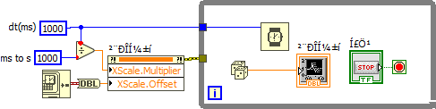

Since dt is constant, all you probably need is the following:
