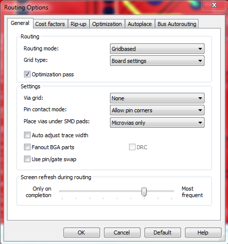

I am beginner to the electronic and multisim. I desing circuit I highly appreciate if you tell me how to create PCB using that
How to create common ground plane
How to calculate and minimum feedback path (any tool on multisim)
How to remove a part of the ground plane from the OP AMP (To reduce parasitic capacitance)
(  I transfer components to the Ultiboard)

Hi there,
1. Select Place=> Power Plane, then choose the Net 0 as the common ground on the spicific Layer you want.
2. For the shortest path, you can ues the Autoroute feature and let the computer optimize it automaticially.
3. If you wanna delete a componnet in Ultiboard, I suggest you delete it in Multisim first and than transfer to the Ultiboard.
Hope it helps.
