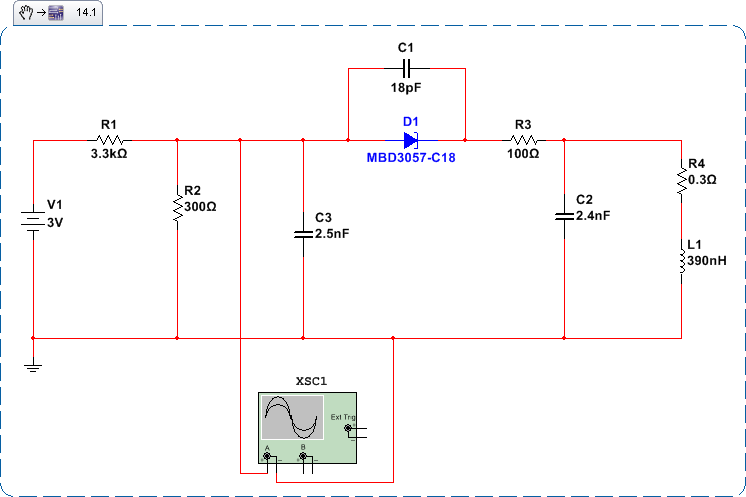

I am trying to simulate a tunnel diode oscillator (TDO) circuit using the tunnel diode elements MBD3057  and 1N3712 found in Multisim.
I played with bias voltage, but cannot get an expected results (oscillating signal).
Please help. Attached is the circuit diagram.

Is there some reason you expect this circuit to work?  It does not look like it would to me. Your capacitors and resistors are too large.   Perhaps you can explain?.

For 1N3712 ,it is ok
