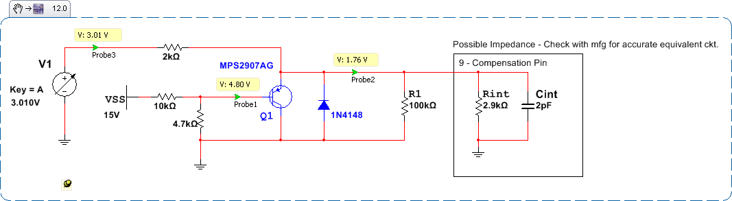

I am very new to multisim, and I am trying to model a portion of this circuit: http://www.ti.com/lit/an/snoa600a/snoa600a.pdf
Scroll down to figure 10, "Son of Godzilla Booster." The portion that I am trying to model is the transistor diode clamp at Q5 and the 1N4148 diode. This circuit is supposed to protect the compensation pin number 9 in the lm3524 switching regulator from receiving more than 4v. Taking a look at the datasheet for the LM3524DN, when pin number 9 sees 1v, it runs at 0% duty cycle, and when it sees 4V, it runs at maximum (45%) duty cycle. I am building this circuit in lab, and after building that part of the circuit, the clamp cuts off at about 5.4 volts instead of 4V as i scroll voltage up past 5V on my power supply.
I have modeled this circuit in multisim, and I have V1 used to represent the 411 opamp voltage output into the 2K resistor, and I have a 15 volt DC source to represent the +15 supply to the 10K resistor.
My multisim model complies quite well with reality and I am wondering if I need to select different resistor values so they will actually limit my voltage to only 4v, OR if there was a good reason for making the cutoff 5.5 volts.

stickshifted,
Since the exact internal structure of the compensation pin (pin 9) is not known, it is likely that the circuit in the Figure takes this into account when calculating the bias point for Q1.   Have you checked this voltage at pin 9 in the lab with the LM3524 in the circuit?   If not, it may be that pin 9 has non-ideal input impedance (R << inf), therefore it is likely that this is basically acting like a parallel resistance with the 100K resistor.   If it does have a large impedance, you can adjust the bias point by changing R2 to something like 2.9k.
An example scenario is shown here (this is a snippet - just drag into Multisim v12 from your browser):
Although a general block diagram of the chip is given, it is very unlikely you'll be able to generate an equivalent circuit with this information only.  It is highly recommended to check with someone from TI on the exact determination of what exactly is the structure on this pin 9 (or ask for an estimate on the equivalent circuit model for the input impedance on pin 9)
- Pat

Stickshifted,
Yes - it does appear to be an older chip, however it appears they still currently sell a new version of that device.
In any case, I definitely over simplified the pin 9 circuit, but through some experimentation and measurements you will likely find a useful equivalent circuit so that you can approximate its structure and get adequate results.
Also note that from your original circuit, I replaced the volt meters with probes (its the yellow icon on right side of schematic sheet, and I formatted it to just display voltage) and I also replaced your static DC source with our new v12 interactive DC source to give you the ability to manually sweep the DC voltage with the slider control while simulating.

man that whole drag and drop thing is pretty cool, and im definitely liking the interactive DC voltage source.
If i dont call Texas Instuments, when I get the chance, ill ask one of the electrical professors to see if I should reduce the clamping voltage or not. So far there is one actual mistake on the schematic, the TY-85 transformer is depicted as having pin number 5 as the centertap - but pin 6 is the actual centertap. pins 5 and 6 just need to be reversed. And this was also confirmed with Triad Magnetics. And when i finally found a place that was selling those ancient transformers, i saw that pins 5 and 7 had blue wires, and pin 6 had a yellow wire indicating that its the centertap.
How do I create those probes that you put on my circuit? I didnt seem to be able to find the same ones when i went to Place Component>Indicators>Probes. Is this something other than a component?
