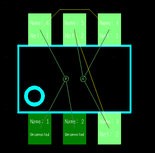

I am having some difficulty with gate swapping on a custom component in Multisim 12. I created an Ultiboard footprint and Multisim component for a dual transistor package. I made it a multi-section component. I used the same pin naming convention as used in Master database part I can successfully gate swap:
I put the each section into a different Gate swap group:
I place the component, make a few connections and transfter to Ultiboard. When I go to Design > Swap gates, the gates pop up as expected. However, when I click gate A, gate B goes away and my only option is to click gate A again.
When I do this, I get the message "Gates cannot be swapped". Of cousre, I don't want to swap gate A with A, because that wouldn't do anything, I want to swap A with B, and I'm not sure what I could be doing wrong.

Thanks for the file. I was able to reproduce the problem and, after testing different scenarios I've found out that this is a potential defect in the software. It seems that when the custom component uses a footprint located in the User Database, the Gate Swap information is not transferred correctly to Ultiboard.
Our developers will be taking a closer look of the issue; for you reference the Corrective Action Request is: 488146.
For now the only suggestion would be to make the changes (gate swap) manually in Multisim and then Forward Annotate to Ultiboard. The other option would be to use a footprint from the Master Database, of course, as long as you find the right footprint there.
