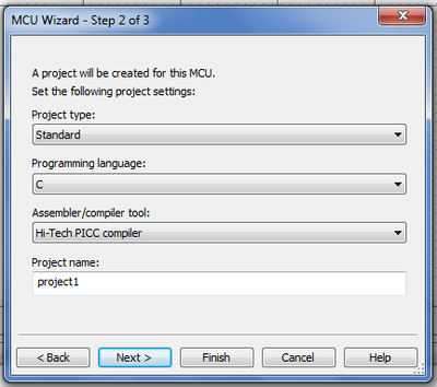

Some further details: I'm trying to use the compiler with the following configuration as in the image

Problem solved.
I had to go to C:\Program Files (x86)\National Instruments\Circuit Design Suite 14.2\hitech and execute the install of hitech compiler.
Apparently, Hitech compiler wasnt installed by default in my multisim.
