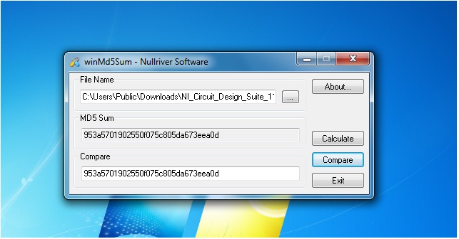

Thanks for reply as you have suggested me to compare both the MD5 Check sum but both are same ie the download is not corrupted so there may be another problem with the installation im also attaching the MD5 checksum screen shot with this reply
kindly look into that
thanks
