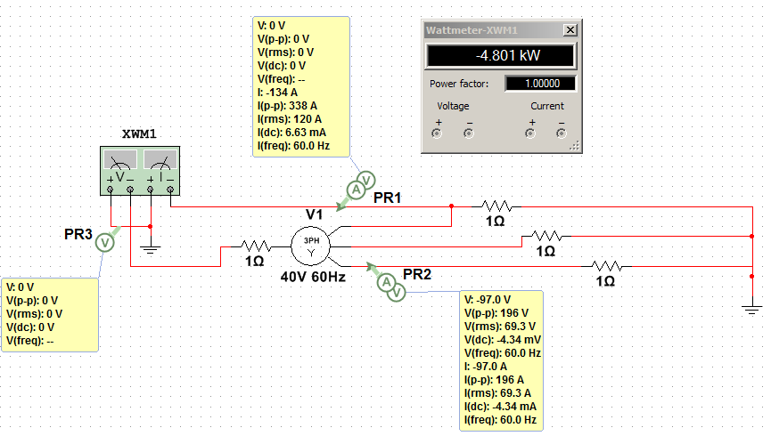

Double the voltage of the 3 phase source and you should expect double the power.
Here you see the RMS current through the shorted leg is now 120 AMPS RMS, and the power is quadrupled which is expected.
After more thought, your neutral is actually connected to ground through a 1 ohm resistor and what should be a very high resistance voltmeter.  The current  going through the ammeter is not shorted as I first believed, it does bypass R15, but then has to flow back through R16 or R17.  So this will lead to the higher RMS currents than expected if the ammeter current was isolated to flowing through R15 or one of the other legs.
One more probe added below
The AC voltage is back to 20 V and on the bottom right you see there is 98 amps peak to peak and 34.6 amps RMS flowing through the neutral wire while there is 60 amps RMS flowing through the ammeter.  This means that 23.4 amps RMS of AC current is flowing through what should be a high impedance voltmeter as the only way the generator neutral is connected to ground is through the one ohm resistor and the voltmeter section of the watt-meter.
I'm open to someone more knowledgeable about AC circuits to further add to this, but I think this is an interesting coincidence and a bug in the multisim watt-meter that it can measure power with no voltage across it and also flow over 20 amps RMS through it with no measurable voltage across it.

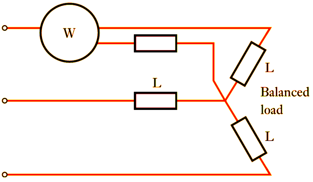

That is why the R18 was there in my circuit.
