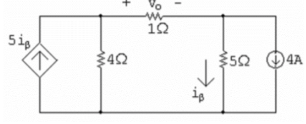

Hi all,
I am very new to Multisim and was wondering if someone could tell me if I built this circuit correctly?  I am trying to find V0:
Screenshot 2020-09-02 at 1.49.42 PM.pngScreenshot 2020-09-02 at 1.56.12 PM.png
(1,536 Views)
your I1 current source is wrong. Instead of having an independent 5A source you should use a current controlled current source that copies the current flowing through R2 (i_beta), multiplies it by 5 and injects the result (5i_beta) into the node between R1 and R3 (see below).
Other than this detail your circuit seems correct.
