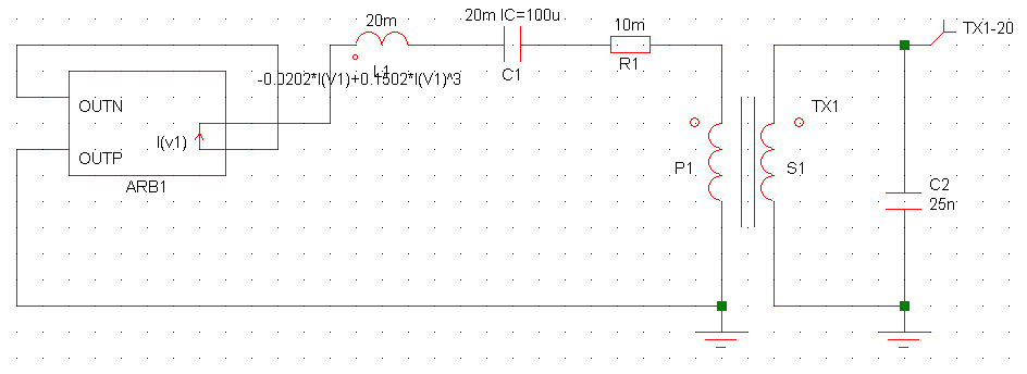

Dear Tayyab R
I need a voltage Source having V-I relation as:
V=-0.0202*I+0.1502*I^3, where I is the current through the source itself.
Below is what I modeled in Simetrix, could I implement this in multisim as well?

Tang_Lihua,
I do not have Multisim but in Spice 3 that can be modeled with a linear independent voltage source (V1) set to 0 and a non-linear dependent source B.
V1 is used to measure the current.  A transient analysis with the UIC option shows a sine wave at about 7 kHz in the circuit listed below. To do an AC analysis, a non-zero value of AC must be entered for V1 or some other source.
Test Arb source
V1 1 2 DC 0 AC 0
B 0 1 V=-0.0202*I(V1)+0.1502*I(V1)^3
Rx 2 0 1G
L1 2 3 20m
C1 3 4 20m IC=100u
R1 4 5 10m
C2 5 0 25n
R2 5 0 1G
.END

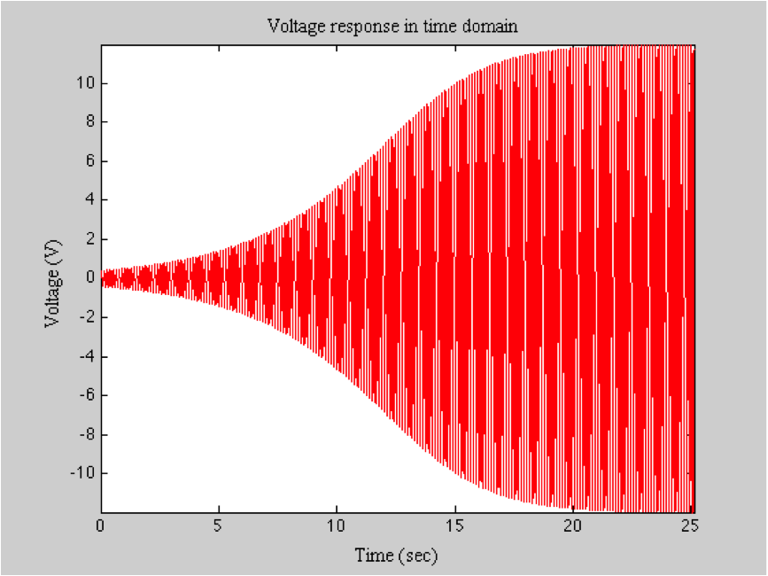

Dear Lynn
thanks for your reply.

Tang_Lihua,
I suspected that the envelope should not be constant but did not take the time to pursue the reason.
The version of Spice that I use is a port of the Berkeley code to the Macintosh called MacSpice. It uses a command line interface.  It does not have any schematic capture or even a text editor.  It can plot results, but I export the data and plot it in a LabVIEW program I am developing so that I have more control over the plotting.
