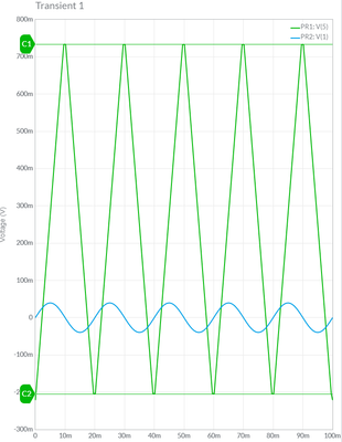

Hi Gabor,
Thanks again for your very detailed response, i have followed your steps and with a Vpp of 4v and a input frequency of 50Hz i have achieved the following:
A peak to peak of 983.63mV on the output and 82mV on the input
Does this seem accurate to you, also with the set up i have, should the output always be larger then the input? As when i increase the frequency the output becomes lower then the input.
I'm sorry these questions may seem basic to you but I'm trying to get my read round the basics and its alot harder then i thought!
Really appreciate the help
Callum

That output is still not right. 4V input amplitude is the upper limit of the supported range. Set it to 2V before anything.
With the 2V input and 50Hz frequency the amplitudes you should get are as follows:
At the divider output / opamp positive input: V+=Vin*100/(10k+100)=19.8mV - this is just the operation of a basic voltage divider considering that the opamp input bias current is negligable.
At the opamp output: Vout=(1+R3/R4)*V+=(1+22k/100)*19.8mV=4.376V
See in the screensot what it should look like for 50Hz. The input is first attenuated by 100 and then amplified by 221, so the total gain is 2.21 with the errors caused by small opamp currents and finite gain. Whatever voltage you apply to the input, the circuit will generate 2.21 times as much as long as the output stays within (VEE...VCC).
The above is true at DC and low frequencies. As you increase the input frequency above a few hundred kHz, the BW limitation will kick in and the output will get smaller and smaller. At exactly 452kHz (Opamp unity gain BW / Gain =100MHz/221=452kHz) you will get 3dB less gain than @ 50Hz, that is the amplitude will be 0.707*4.376V=3.1V. See the second screenshot for the AC response.
(3,377 Views)
