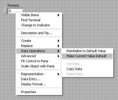

P.S. Also I set up my filter parameters and save them but everytime that I reopen the vi the filter values go back to the default settings. Is there a way to save my settings permenately.

HI Ray,
This error seems to be coming from the Waveform Peak Detection vi, Based on the error it appears that either your VI or a sub VI has somehow become corrupted. The first thing that I would try is to copy your entire VI into a new blank VI and attempting to run it. If this does not work then in order to narrow down the source you could simulate a waveform and use the Peak Detection VI in a test VI. If none of these trials change anything then I would suggest repairing your installation of LabVIEW. This can be done by navigating to Add/Remove programs>> National Instruments Software>> LabVIEW 8.0 and selecting repair.  You can also attempt to run this VI on another computer to verify that it is not something wrong with the programming but rather a corruption. With regards to the filter parameters in the VI that you posed there are no controls on the terminals so I am assuming these are incomplete, but I have attached a screenshot of how to set the default value for a control. I hope this helps!!

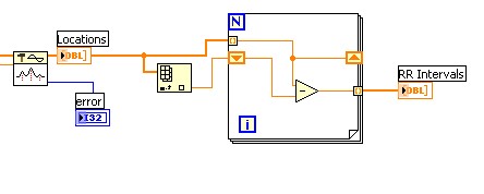

Hi Ray,
I believe that the issue stems from the inherent discontinuity in the ECG signal. I believe that taking a derivative is unnecessary and that the following method should work. I believe something like this:
should work if used on your waveform data. I do not have a ecg signal so therefore cannot test this. If you could post some of your data that would be helpful. I do however believe that this method should give you satisfactory results.
