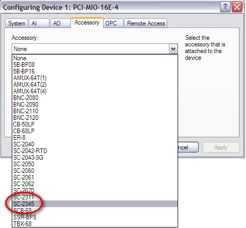

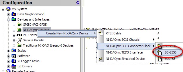

Tom,
Yes, you can use the SC-2350 as an accessory in DAQmx.
However, you cannot use is as an accessory in Traditional though, as this accessory is meant only for DAQmx. As shown below, only the SC-2345, which can be used in traditional DAQ, shows up in the list.
