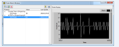

hardware and software as follows:
win7, labview 2017, daqmx 17.0
cdaq 9185, 9201*1, 9263*1
vi for test is very simple, the same as example. for ai task, sample rate is 10k and read points are 100; for ci task, software time is used and while loop inteval is 10ms.
then question is:
when single ai task only, time of ai loop is 10ms, like this, as expected.
when single ci task only, time of ci loop is 10ms, like this, as expected.
while both ai and ci task are on, both ai and ci loop time are very unstable(30, 0, 0, 30, 0, 0 and such), like this.
vis for test below:
we test this in pcie-6341, in all situations, the time of loop is 10ms, as expected.
why is in cDAQ?

No definitive answers, just trying to focus on clues.
The CI task pretty much alternates iterations -- 1 slow, 1 fast, 1 slow, 1 fast.  The only way to get a "fast" iteration of ~0 msec is if the previous iteration had DAQmx Read executing *after* the end of the 10 msec wait while the current iteration executes DAQmx Read immediately (as the 10 msec wait is just starting).
    This implies that in the previous iteration, at least 10 msec passed before DAQmx Read was able to execute.  Nothing in the code prevented it, so I start wondering about the driver and particularly about its attempts to negotiate access / priority to the USB bus while the AI task is also demanding access.
    Not sure if you'll get useful information from this, but I'd do trials where the 10 msec wait is moved to each of the various sequence frames in turn.  It's possible that other timing patterns will emerge that help you or someone else in the diagnosis.
The AI task has a more interesting pattern.  The timing pattern cycles about every 4 iterations.  I'm gonna guess that on average, in the long run, the loop is keeping up with the task.  So the sum of every 4 iterations should keep being 40 msec.
   It's clear you get long iterations that are typically about 32-33 msec, followed by 2 cycles of 0 msec.  There must be another point along the rising slope to account for the remaining 7-8 msec.   Roughly speaking, the pattern goes 32-0-0-8-32-0-0-8-32-0-0-8.
   The 0 msec iterations happen when the task has built up a little backlog in its buffer.  They're available *immediately* without waiting when DAQmx Read is called.  The 8-ish msec cycle probably means that the previous iteration almost-but-not-quite emptied out the task backlog.  So the call to DAQmx Read finds 2 msec worth of backlogged samples already present and waits 8 msec to receive the rest of the chunk it was asked for.
    That *ought* to get the reading loop back in sync with the task, so that subsequent iterations could be expected to settle back in at 10 msec each.  But it doesn't happen and I simply don't know what causes the next iteration to consistently take this extra time.

again, something update.
we found another cDAQ-9185 chassis in other product line and made a similar test.
os: win7 64bit,
labview:2019
daqmx driver:19.0.0f1
cdaq firmware:17.1.0f5
chassis: cDAQ-9185, ethernet
module: 9203*2, 9263*1
we create a ai  task and an ao task, refer to the pic below. when only one task is on, the inteval times are all expected, but both tasks are on, the intevals are unstable and the result cann't be understood as described in this topic.
It means in situation of multiple tasks, the timing is unpredictable.
