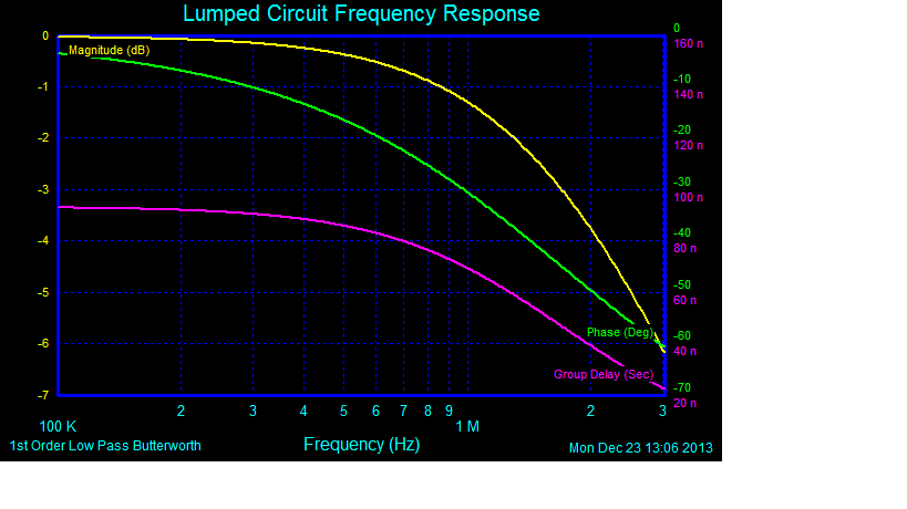

Thanks for the answer. I will indeed insert a higher order filter into the signal chain.
Nonetheless, the linearity in phase response doesn't seem to change that radically, lets say, a 3rd order filter:
Plot for a 1st order filter:
Plot for a 3rd order Butterworth filter:
The band pass is in both cases 1.7MHz.
There seems to be no relevant difference for signals below 1MHz (Group Delay is going in the opposite direction, but the change is of similar magnitude). The change in Phase about doubled...I guess will have to read a bit, whether this is relevant.
